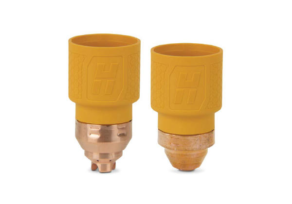

![Mechanized and FineCut for machine torches](/globalassets/products/sync/bs_cartridge-grey_revb_600x420.jpg)
Hypertherm cartridges |
Process |
Cartridge |
105 A |
85 A |
65 A |
45 A |
FineCut mechanized cutting |
Ohmic ring kit |
(contains 3 #420580 ohmic rings) |
Replaces this stack-up |
Shield |
Retaining cap |
Nozzle |
Electrode |
Swirl ring |
220993 |
220854 or 220953 (Ohmic) |
220990 |
220842 or 220777 |
220994 |
220817 |
220816 |
220819 |
220857 |
220941 |
220948 or 220955 |
220930 |
220947 |
