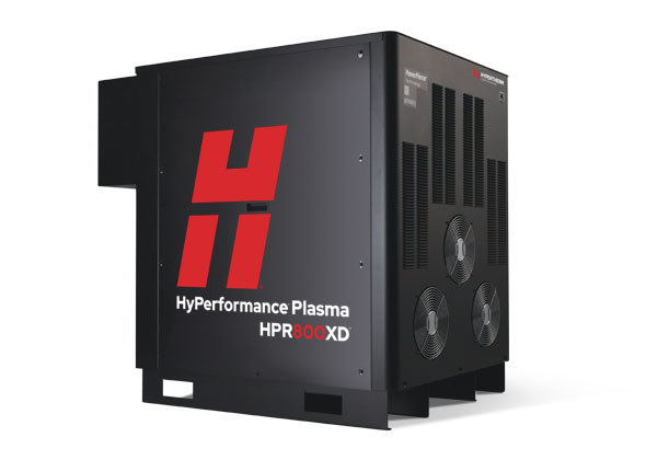

HyPerformance HPR800XD

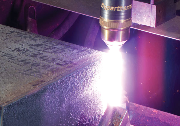

The HyPerformance® HPR800XD® plasma system has been designed and built for maximum performance and productivity in X-Y, bevel and robotic cutting operations. The versatile 800-amp rated system combines fast cutting speeds, rapid process cycling, quick changeovers and high reliability, and offers unmatched process flexibility to cut, bevel and mark metals up to 160 mm (6 1/4″) thick.

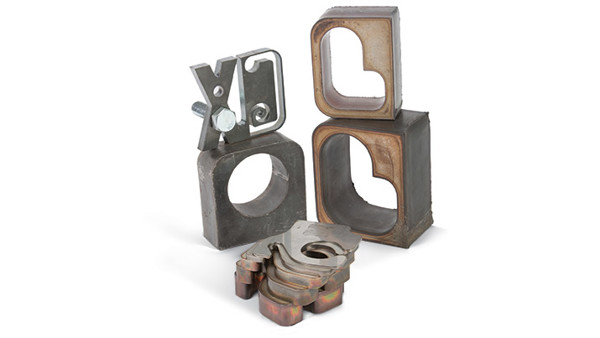

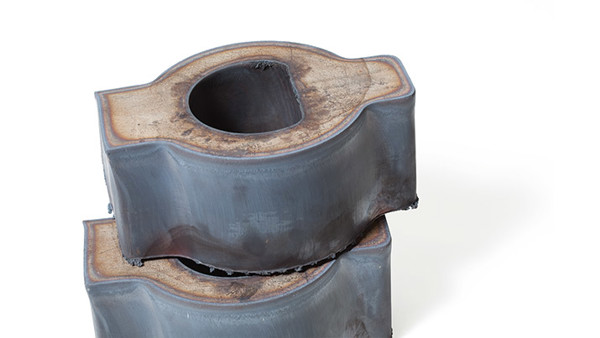

Superior cut quality and consistency
  • HyPerformance plasma cuts fine-feature parts with superior quality and consistency
  • HyDefinition® technology aligns and focuses the plasma arc for more powerful precision cutting up to 6-1/4" (160 mm)

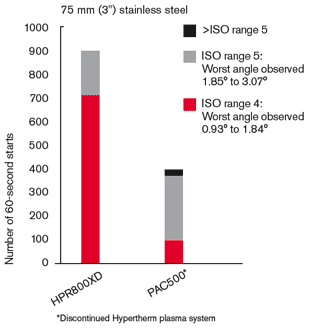

  • New HDi™ technology delivers HyDefinition cut quality on thin stainless steel, with extremely sharp top edge quality, shiny surface finish, and superior angularity with reduced angle variation

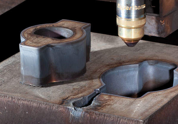

  • Patented True Hole™ technology (auto gas systems only) produces hole quality that is significantly better than anything previously achievable with plasma

  • Patented PowerPierce® technology lets you pierce  thicker than ever before and replace slower-cutting oxyfuel technology

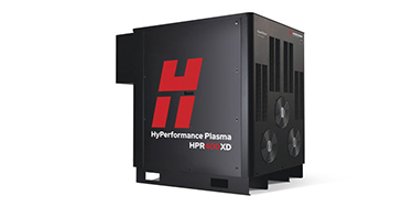

The HPR800XD system is comprised of two HPR400XD systems in parallel. Each power supply has the following specifications.
General
Maximum OCV (U0) 360 VDC
Maximum output current (I2) 400 Amps
Output voltage (U2) 50 – 200 VDC
Duty cycle rating (X) 100% @ 80 kw, 40° C (104° F)
Ambient temperature/Duty cycle Power supplies will operate between -10° C and +40° C (+14° and 104° F)
Power factor (cosφ) 0.98 @ 400 ADC output
Cooling Forced air (Class F)

Mild steel cut capacity Dross free
Production pierce
Maximum cutting capacity
38 mm (1-1/2")
50 mm (2")
80 mm (3.2")
Stainless steel cut capacity Production pierce
Maximum pierce**
Severance
75 mm (3")
100 mm (4")
160 mm (6-1/4")

Cut angle ISO 9013 range*
2-5

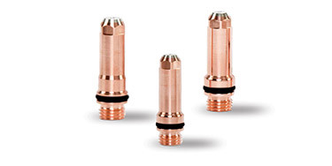

Shield cap     Shield   Nozzle retaining cap       NozzleSwirl Ring Electrode Water tube  30 amp Torch consumable parts
400 amp consumables - mild steel
Amperage Shield
cap
Shield Nozzle
retaining cap
Nozzle Swirl ring Electrode SilverPlus
electrode
Water tube
30 A 220747 220194 220754 220193 220180 220192 ______ 220340
50 A 220747 220555 220754 220554 220553 220552 ______ 220340
80 A 220747 220189 220756 220188 220179 220187 420566 220340
130 A 220747 220183 220756 220182 220179 220181 220665 220340
200 A 220637 220761 220757 220354 220353 220352 220666 220340
260 A 220637 220764 220760 220439 220436 220435 220668 220340
400 A 220637 220636 220635 220632 220631 220629 420530 220571
80 A bevel 220637 220742 220845 220806 220179 220802 ______ 220700
130 A bevel 220637 220742 220740 220646 220179 220649 ______ 220700
200 A bevel 220637 220658 220845 220659 220353 220662 ______ 220700
260 A bevel 220637 220741 220740 220542 220436 220541 ______ 220571
* 260 A bevel 220637 220897 220896 220898 220436 220899 ______ 220571
400 A bevel 220637 220636 220635 220632 220631 220629 ______ 220571
