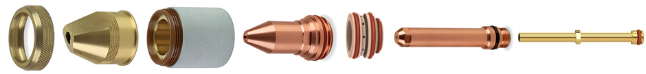

MAXPRO200 machine torch consumables
Air – Mild steel / Stainless steel / Aluminum
Shield Shield cap Nozzle Swirl ring Electrode Water tube
200 amp - Air consumables - Mild steel / Stainless steel / Aluminum
Amperage | Shield | Shield cap | Nozzle | Swirl ring | Electrode | Water tube |
50 A | 220532 | 220936 | 220890 | 220529 | 220528 | 220521 |
220935 without tab | ||||||
130 A | 220536 | 220936 | 220892 | 220488 | 220487 | 220521 |
200 A | 420045 | 220936 | 420044 | 220488 | 220937 | 220521 |
