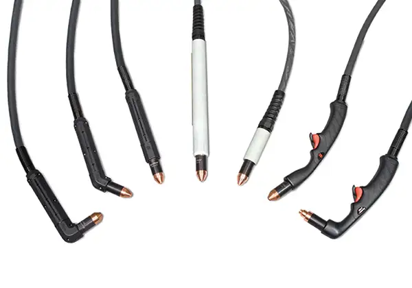

For hand cutting and gouging jobs
Duramax® 75° and 15° hand torches are well suited for a variety of applications such as gouging, fine feature cutting, extended reach cutting, and flush cutting. The ergonomic design of the 75° torch is perfect for normal cutting, while the 15° torch directs heat away from the operator during heavy gouging and enables cutting overhead or in hard-to-reach areas.
Duramax hand - 75 and 15 degrees torches
For machine jobs
Duramax full-length machine torches work with a wide variety of CNC cutting tables, track cutters, and pipe-cutters. Mini machine torches are perfectly suited for lighter tables and pipe cutting situations where the full-length torch is too long.
Duramax 180 degrees full and mini machine torches
For robotic jobs
The light weight, small size and built-in positioning features of Duramax robotic torches enable easy integration and operation with light robot arms. An optional clamp speeds integration.
Duramax robotic - 180, 90 and 45 degrees torches
