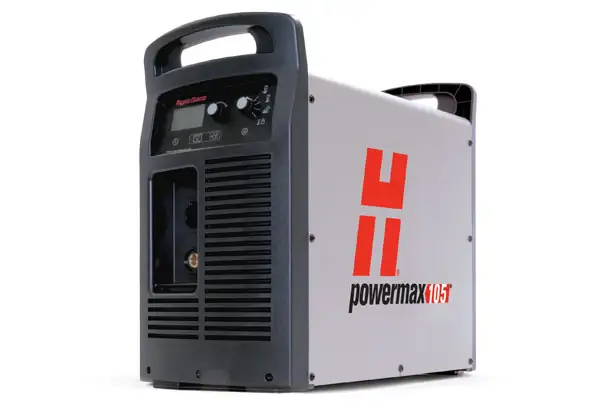

Powermax105 plasma cutter
The Powermax105® 105-amp plasma power supply will stop manufacturing in December 2021, and will no longer be available for sale from Hypertherm. We continue to make original replacement torches, consumables, and repair parts. Refer to the Torches and consumables section for additional upgrade options.
Hypertherm Technical Service department still supports this model.
