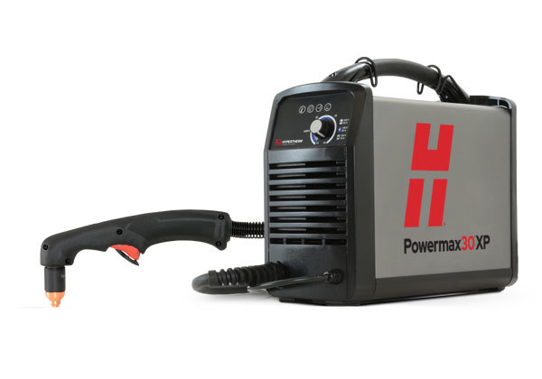

Powermax30 XP plasma cutter

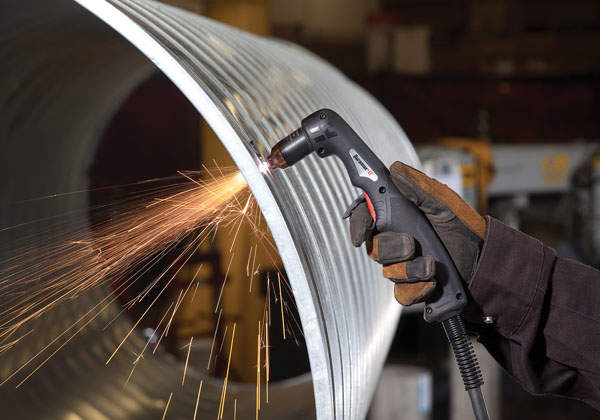

The Powermax30® XP is a highly portable plasma cutter designed to handle a wide range of jobs. A unique “two-in-one” design provides high-power capability for thick metal cutting, as well as FineCut® consumables for detailed, thin metal cutting. In addition to cutting any electrically conductive metal, such as mild steel, stainless steel, or aluminum, this 30-amp plasma cutter can also gouge metal. The Powermax30 XP boasts dual-voltage capabilities. In addition to 240 V, you can plug it into a standard household socket and use as a 120 V plasma cutter.

“Two-in-one” design for maximum versatility
- High-power cutting on thick metal
- FineCut consumables enable high quality cuts on thin metal, leaving a clean edge and a narrow kerf
Specifications
Input voltages | 120-240 V, 1-PH, 50/60 Hz |
Input current @ 3.8 kW | 120-240 V, 1-PH, 25-18.8 A |
Output current | 15-30 A |
Rated output voltage | 125 VDC |
Duty cycle @ 40°C (104°F) | 35%, 240 V 20%, 120 V |
Open circuit voltage (OCV) | 256 VDC |
Dimensions with handles | 356 mm (14.0") D; 168 mm (6.6") W; 305 mm (12.0") H |
Weight w/ 4,5 m (15') torch | CSA: 9.7 kg (21.4 lbs) CE, CCC: 9.5 kg (21 lbs) |
Gas Supply | Clean, dry, oil-free air or nitrogen |
Recommended gas inlet flow rate / pressure |
113.3 l/min (4 scfm) at 5.5 bar (80 psi) |
Input power cable length | 3 m (10') |
Power supply type | Inverter - IGBT |
Engine drive requirement | 5.5 kW for full 30 A output |
Certifications | CSA-certified for use in the Americas and Asia, except China CE, C-Tick, CU/GOST, Ukr, and Serbian — for use in Europe, Australia, Belarus, Kazakhstan, Russia, Serbia, Ukraine, and other countries where accepted. CCC for use in China. |
Warranty | Power supplies have a 3-year warranty and torches a 1-year warranty. |
