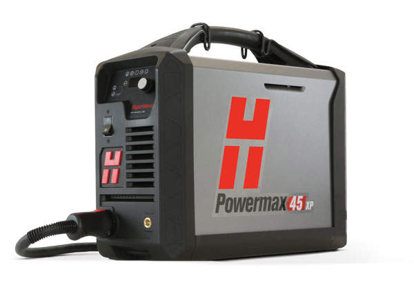

Powermax45 XP plasma cutter
The Powermax45® XP plasma cutter provides a recommended cut capacity – up to 16 mm (5/8″) – as well as fast cut speeds, and automatic gas adjustment for quick, simple setup and operation. Duramax® Lock torches support handheld and mechanized cutting of a wider range of metal thicknesses, along with precision gouging such as spot weld removal, and marking capabilities.

Benefits
Easy to use
- Small size and light weight provide exceptional portability for a 16 mm (5/8") rated cutting system
- Patented drag-cutting technology makes the Powermax45 XP easy to use – even for first-time operators
- Smart Sense™ technology ensures that air pressure is always correctly set
![AS_45XP_P1070069_400x400.jpg](/globalassets/products/powermax/powermax45-xp/as_45xp_p1070069_400x400.jpg)
Outstanding versatility
- CNC interface and FastConnect™ torch connection allows both handheld and mechanized operation
- A wide range of torch and consumable styles to choose from for both handheld and automated processes
- Extensive array of application capabilities via specialty consumables for fine feature cutting, extended reach cutting, gouging, precision gouging, and marking
![AS_45XP_VOTECH_P1000327_400x400.jpg](/globalassets/products/powermax/powermax45-xp/as_45xp_votech_p1000327_400x400.jpg)
Maximum productivity
- Finish jobs faster, with cut speeds 1.5 times greater than oxyfuel on 6 mm (1/4") mild steel
- Superior cut and gouge quality reduces time for grinding and edge preparation
- New torch disable switch feature allows faster, easier changeout of consumables
![CHT_45XP_500x500.png](/globalassets/products/powermax/powermax45-xp/cht_45xp_500x500.png)
Rugged and reliable
- Duramax® Lock torches are designed for high-impact and heat resistance
- SpringStart™ technology ensures consistent starting and optimum torch performance
- Hypertherm Certified™ reliability ensures peak performance even in the most demanding environments
![Powermax Duramax Lock torches](/globalassets/products/powermax/powermax45-xp/as_45xp_duramaxlock_400x400.jpg)
Designed for low environmental impact
- Plasma cutting efficiency is 11% better than its predecessor, enabling you to cut more steel with less power, in less time
- All plasma system components are recyclable
- 14% lighter than its predecessor and delivers more cutting power
