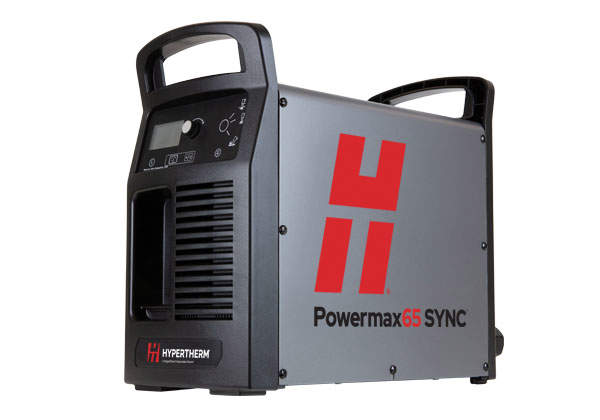

Powermax65 SYNC plasma cutter
The Powermax65 SYNC® is a next-generation professional grade air plasma cutter that dramatically simplifies system operation for gouging and recommended cutting up to 20 mm (3/4″). Featuring automated system process set-up via advanced RFID-enabled SmartSYNC® torches and a revolutionary single-piece cartridge consumable that provides trackable utilization data. The Powermax65 SYNC maximizes productivity through reductions in downtime, optimized cut quality performance and streamlined consumable inventory management.

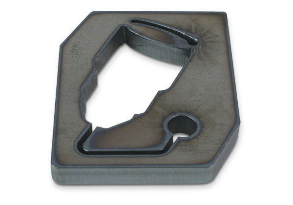

Fine feature cutting
Flush cutting

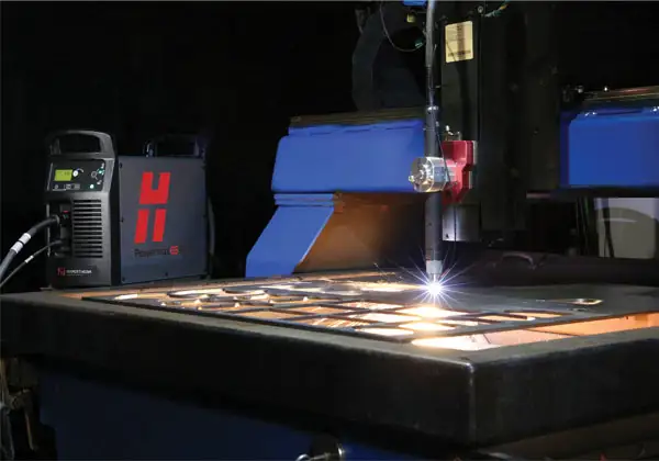

Mechanized cutting

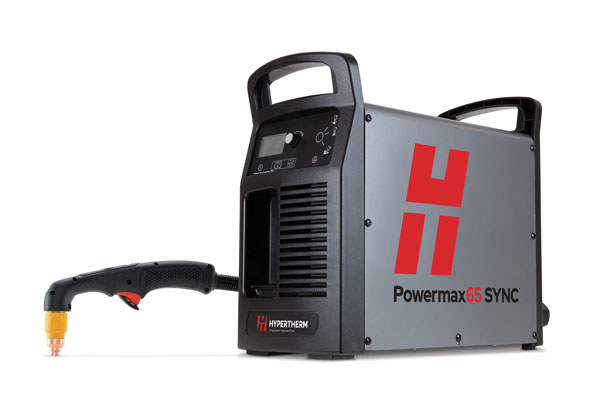

SmartSYNC torches
SmartSYNC torches feature RFID capability that when coupled with a Hypertherm cartridge will communicate with a Powermax SYNC system to automatically set the amperage and process on the power supply. Available in handheld, mechanized and robotic torch configurations.

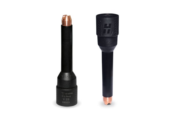

Hypertherm cartridges
FlushCut options
Hypertherm cartridges |
Process |
FlushCut™ |
| 65 A | |
