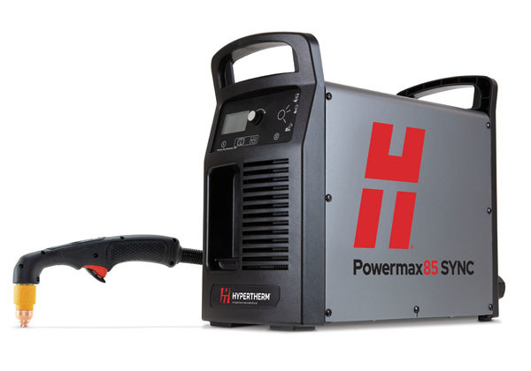

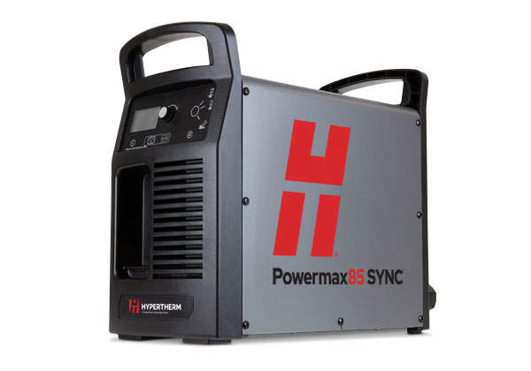

Powermax85 SYNC plasma cutter
The Powermax85 SYNC® is a next-generation professional grade air plasma cutter that dramatically simplifies system operation for gouging and recommended cutting up to 25 mm (1″). Features automated system process set-up via advanced RFID-enabled SmartSYNC® torches and a revolutionary single-piece cartridge consumable that provides trackable utilization data. The Powermax85 SYNC maximizes productivity through reductions in downtime, optimized cut quality performance and streamlined consumable inventory management.

Benefits
Easy to use
  • Cartridges are easy to identify by process with clear laser marking and color coding to eliminate part mix-ups.
  • RFID-enabled SmartSYNC torches and cartridges automatically set the correct amperage and operating mode, eliminating setup errors.
  • End-of-life consumable detection eliminates the uncertainty of knowing when to change the cartridge.
  • Less operator fatigue when using hand torches with our new flexible lead. The lead has the same robustness of our previous lead jacket material and will also be used on robotic torches.
Cartridge reader and RFID
Minimize operation costs
  • Simplified system operation minimizes the time and costs spent on training and troubleshooting.
  • Reductions to downtime during consumable change-outs and elimination of costs associated with premature disposal of consumable parts.
  • Cartridge usage data provides valuable insights for improving cutting operations and consumable inventory management.
Maximize performance
  • Tackle a wide range of jobs with easily interchangeable torch styles and application specific cartridges for various types of cutting and gouging.
  • Optimized cartridge consumable design provides up to twice the life for handheld cutting and improved quality over life in mechanized setups compared to standard consumables.
  • Time-saving hand torch controls allow the operator to adjust the amperage on the fly, change cartridges and applications without returning to the power supply.
Industry-leading reliability
  • SmartSYNC torches are engineered for rugged, industrial environments.
  • SpringStart™ technology ensures consistent starting and a more reliable torch.
  • Industry-leading reliability reduces production downtime.
Specifications
Cut capacity
Capacity Thickness Cut speed
Recommended 25 mm (1″) 500 mm/min (20 ipm)
  32 mm (1-1/4″) 250 mm/min (10 ipm)
Severance (hand cutting) 38 mm (1-1/2″) 125 mm/min (5 ipm)
Pierce* 20 mm (3/4″)
*Pierce rating for handheld cutting, or mechanized cutting with programmable torch height control.
Maximum removal gouging
Capacity Metal removal rate Gouge profile
Typical gouge 8,2 kg (18.2 lbs.) per hour 3,5 mm D x 6,6 mm W (0.14″ D x 0.26″ W)
General specifications
Input voltages
CSA
  • 200–480 V, 1-PH, 50/60 Hz
  • 200–600 V, 3-PH, 50/60 Hz
CE
  • 380/400 V, 3-PH, 50/60 Hz
Kilowatt output
12.2 kW
Input current
CSA
  • 200/208/240/480, 1-PH 70/68/58/29 A @ 12.2 kW
  • 200/208/240/480/600 V, 3-PH 42/40/35/18/17 A @ 12.2 KW
CE
  • 380/400, 3-PH 20.5/19.5 A
Output current
25–85 A
Rated output voltage
143 VDC
Duty cycle @ 104° F
CSA
  • 60% @ 85 A, 230–600 V, 3-PH
  • 60% @ 85 A, 480 V, 1-PH
  • 50% @ 85 A 240 V, 1-PH
  • 50% @ 85 A, 200–208 V, 3-PH
  • 40% @ 85 A, 200–208 V, 1-PH
  • 100% @ 66 A, 230–600 V, 1/3-PH
CE
  • 60% @ 85 A, 380–400 V, 3-PH
  • 100% @ 66 A, 380–480 V, 3-PH
Open circuit voltage (OCV)
CSA: 305 VDC
CE: 270 VDC
Dimensions with handles
483 mm D; 233 mm W; 430 mm H (19″ D; 9.2″ W; 17″ H)
Weight w/7.6 m (25′) torch
CSA: 32 kg (67 lbs.)
CE: 23.5 kg (52 lbs.)
Gas supply
Clean, dry, oil-free air or nitrogen
Optimum inlet gas pressure
7.6–8.3 bar (110–120 psi)
Minimum inlet gas pressure
5.2 bar (75 psi)
Recommended inlet gas flow rate
Cutting: 210 I/min @ 5.9 bar (450 scfh, 7.5 scfm @ 85 psi)
Gouging: 210 I/min @ 4.8 bar (450 scfh, 7.5 scfm @ 70 psi)
Input power cable length
3 m (10′)
Power supply type
Inverter–IGBT
Engine drive requirement
20 kW for full 85 A output
Electrical efficiency
91.9%
Certifications
  • CSA – for use in the Americas and Asia, except China
  • CE – for use in Europe, Australia & New Zealand - RCM, Serbia, UK - UKCA, Ukraine, and other countries where accepted.
  • CCC – for use in China
Warranty
Power supplies have a 3-year warranty and torches a 1-year warranty

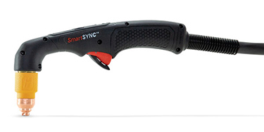

SmartSYNC torches
SmartSYNC torches
SmartSYNC torches feature RFID capability that when coupled with a Hypertherm cartridge will communicate with a Powermax SYNC system to automatically set the amperage and process on the power supply. Available in handheld, mechanized and robotic torch configurations.
