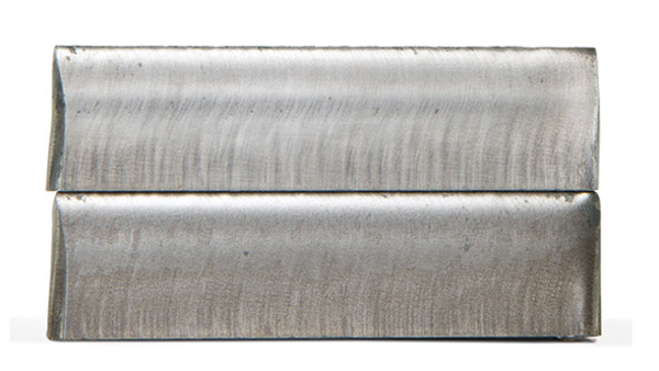

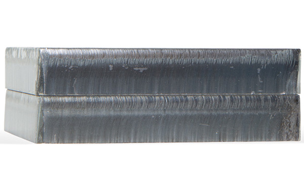

Industry-leading X-Definition cut quality
The XPR advances HyDefinition® cut quality by blending new technology with refined processes for next generation, X-Definition™ cutting on mild steel, stainless steel and aluminum.
  • Consistent ISO range 2 results on thin mild steel
  • Extended ISO range 3 cut quality results compared with earlier plasma technology

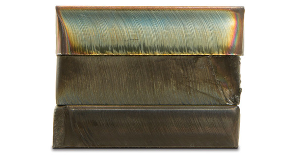

  • Superior stainless steel cut quality across all thickness ranges
  • Superior results on aluminum using Vented Water Injection™ (VWI)
