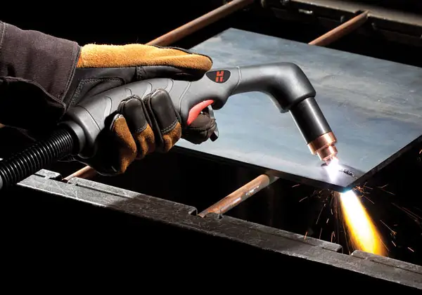

Duramax™ retrofit torches can give older Powermax system new life with enhanced performance and productivity. Available for Powermax600/800/900 and MAX42/43 systems, –retrofit torches use the torch connection designed for your system, so installation is simple; both handheld and mechanized styles are available with or without quick disconnect.
- Handheld and machine styles available
- Proprietary, fiber-reinforced torch handle is 5 times more impact resistant and 20% more heat resistant than T-style torches
- SpringStart™ electrode technology eliminates moving parts in the torch for more reliable arc-starting

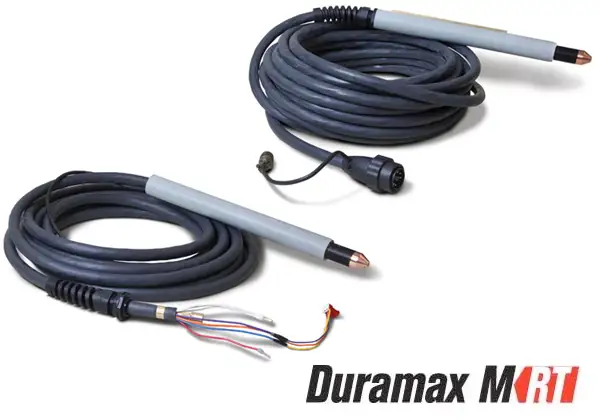

Duramax MRT mechanized torches with and without quick disconnect
Torch assemblies
Consumables, operator manual and consumables sticker for your system included.
| Part number | Description - Systems |
| 228920 | MRT machine torch assembly, 7.6 m (25' ) leads - Powermax600, Powermax800, Powermax900, MAX42, MAX43 |
| 228921 | MRT machine torch assembly, 15.2 m (50') leads - Powermax600, Powermax800, Powermax900, MAX42, MAX43 |
| 228922 | MRT machine torch assembly, 7.6 m (25' ) leads* - Powermax600 CE |
*Without quick disconnect

| Consumable type |
Amperage | Shield / Deflector | Retaining cap | Nozzle | Electrode | Swirl ring |
| Mechanized | 40 A - 55 A | 220817 | 220854 | 220941 | 220842 or 220777 * | 220857 |
| Mechanized, Ohmic | 40 A - 55 A Ohmic | 220817 | 220953 | 220941 | 220842 or 220777 * | 220857 |
| Unshielded | 40 A - 55 A | 220955 | 220854 | 220941 | 220842 | 220857 |
| Max removal gouging1 | 40 A - 85 A | 220798 | 220854 | 220797 | 220842 | 220857 |
| Max control gouging2 | 40 A - 85 A | 420480 | 220854 | 220797 | 220842 | 220857 |
| FineCut | 40 A - 45 A | 220955 | 220854 | 220930 | 220842 | 220857 |
| 40 A - 45 A Ohmic | 220948 | 220953 |
* For improved consumable life try the CopperPlus electrode.

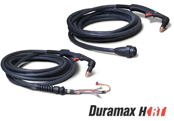

Duramax HRT hand torches with and without quick disconnect
Torch assemblies
| 228916 | HRT hand torch assembly, 7.6 m (25') leads - Powermax600, Powermax800, Powermax900, MAX42, MAX43 |
| 228917 | HRT hand torch assembly, 15.2 m (50') leads - Powermax600, Powermax800, Powermax900, MAX42, MAX43 |
| 228918 | HRT hand torch assembly, 7.6 m (25') leads* - Powermax600 CE |
* Without quick disconnect

| Consumable type | Amperage | Shield / Deflector | Retaining cap | Nozzle | Electrode | Swirl ring |
| Drag-cutting | 40 A - 55 A | 220818 | 220854 | 220941 | 220842 or 220777* | 220857 |
| FineCut | 40 A - 45 A | 220931 | 220854 | 220930 | 220842 | 220947 |
1 Designed for aggressive metal removal, achieving deep gouge profiles and extreme metal washing applications.
2 Designed for more precise metal removal, achieving a shallow gouge profile and light washing applications.
